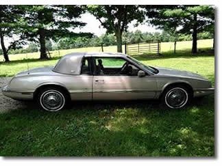

1990 Buick RivieraMy son put two stroke gas in his empty gas tank and now it starts but then dies right away. What should he do?
The 2-stroke mix shouldn’t make a big difference at all. If the car has been run out of gas, you will need to prime the fuel system. This can be done by cycling the ignition key on and off 10 times, pausing 5 seconds between each. This will refill the fuel lines and fuel filter in order to allow proper fuel pressure to each fuel injector.
