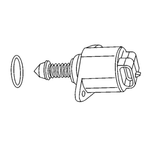

If it will not stay running unless you hold your foot on the pedal, the most likely cause would be a sticking IAC – Idle Air Control Valve.

Idle Air Control Valve Replacement
Removal Procedure
- Remove the throttle control cable bracket from the throttle body. Refer to Accelerator Control Cable Bracket Replacement .
- Remove the canister purge valve. Refer to Evaporative Emission Canister Purge Solenoid Valve Replacement .
- Disconnect the idle air control (IAC) electrical connector.
- Remove the idle air control valve attaching screws.
- Remove the idle air control valve.
- Remove the idle air control valve O-ring.
Installation Procedure
- Install the new idle air control O-ring.
- Install the idle air control valve into the throttle body.
