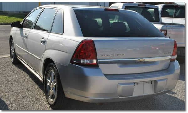

I have a 2006 Chevrolet Malibu Maxx and the ABS light and traction control lights came on at the same time…. what could be wrong?
Most common reason would be the ABS Sensor inside the hub bearing assembly. The entire hub bearing will have to be replaced. The hub bearing starts to wear and damages the internal speed sensor. This will cause the ABS Light and traction control light to come on. The good news is the car can be driven without fear of it braking down. However the traction control and the ABS will not be functional.
