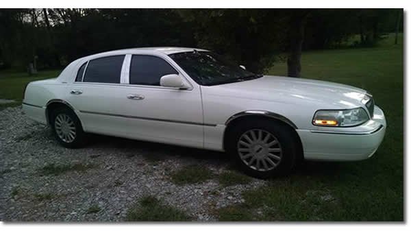

I have a 2002 Lincoln Town Car and I have blown fuse number 6 Electronic Automatic Temperature Control(EATC) twice in the last 2 days. The car is running with the air conditioning on and then an hour latter it blows.
Most likely reason would be the Air Conditioning clutch relay is sticking. May also have a short coming from the clutch switch. Could be the switch or the wiring. I will provide a wiring diagram for better understanding of the blown fuse number 6.
