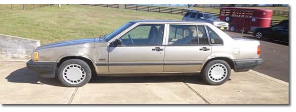

1994 Volvo 940 na
1994 Volvo 940no spark at coil have replaced ckp coil ecu and power state out of ideas
