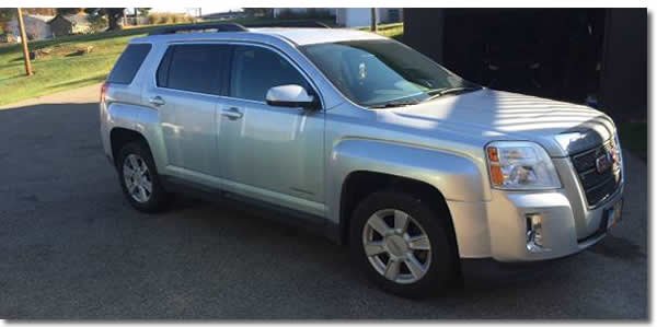

2012-GMC TerrainThe entire display and radio quit working, all fuses are good,? thanks
