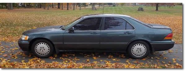

1997 Acura RL97 Acura RL. Vehicle won’t start. Battery is fine, starter is fine. Fuel pressure fine. Spark at coils fine. Has not jumped timing A scan revealed a Coolant Temperature Sensor code. Replaced and cleared code. Still no start. Ideas? Trying to avoid replacing unneeded things for the sake of trying it (knock sensor, camshaft positioning sensor, ECM, etc). So what further things could I do to diagnose this no start?
