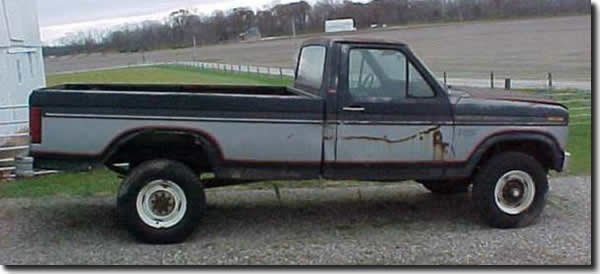

Truck set up for 3 years. I put in new fuel, battery, had to push start, then started well till it sits for a few hours, then have to push start again.
