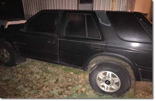

1994 Honda Passport
How do you remove the lower part of the timing belt cover the water pump is behind? It is a 1994 Honda Passport with a 24v V6.
