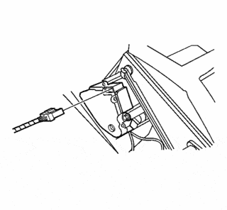

This is very common of a failed blend door actuator. Replacing the failed actuator will take core of the air conditioning problem. The AC will blow cold out both sides once again.
Air Temperature Actuator Replacement – Left Side
Removal Procedure
- Remove the left instrument panel insulator.
- Remove the knee bolster bracket bracket.
- Disconnect the electrical connector from the left air temperature actuator.
- Remove the mounting screws from the left air temperature actuator.
- Remove the left air temperature actuator.

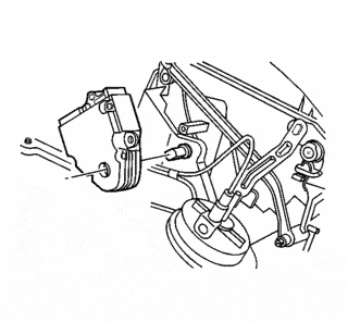

Installation Procedure
- Position the left air temperature actuator, then align the slots in the electric actuator driver to the flats on the shaft.
- Align the locating hole to the alignment pin on the HVAC module case.
- Slide the actuator on the shaft. The actuator driver should seat completely on to the shaft and the mounting holes should be flush with the mounting screws on the HVAC module case.
- Install the mounting screws to the left air temperature actuator.
Tighten
Tighten the left air temperature actuator screw to 1.5 N·m (13 lb in).
