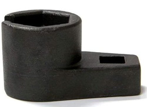

How to change Air Fuel Sensor
- Remove harness connector of air fuel ratio A/F sensor
- Remove the air fuel ratio A/F sensor is a 7/8 (22 mm) offset oxygen sensor socket.( the socket has a slot in one side to allow siding over the wiring harness.
Offset Oxygen Sensor Socket
- Size: Common 6 point, 7/8 inch (22 millimeter) hex fits almost all oxygen sensors; 3/8″ drive for ratchets.
- Design: This socket’s slotted design allows you to remove oxygen sensors with the wiring harness still attached, and the unique off set design of the T7822F Oxygen Sensor Wrench delivers maximum torque with maximum convenience! Made to increase torque on hard-to-remove O2 sensors and allows you to access tough spots, easily!
