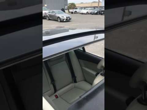

Roof stopped closing in middle of the operation. I had to use the manual lever to close but doesn’t lock into place. How can this be reset so the roof can be locked in again? Cheers
You will need to make the needed repairs in order for the sun roof to function properly.
Sun Roof Troubleshooting
Check voltage supply to fuse#9 and replace as needed. Ensure voltage is present at the sun roof switch terminal #10(Red Wire). Ensure voltage supply to stepping relay, motor, and microswitch is present at switch terminals #3(Yellow Wire) and #4(Blue Wire) by setting switch in different positions. Check all connections, wiring and grounds.
