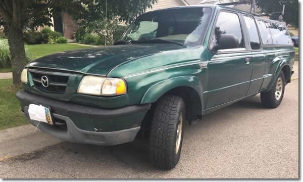

I just bought a mazda b4000 and the guy told me that I had to put in neutral to put on 4×4 and then put it in reverse when the light comes on but I’ve put it on drive to turn the 4×4 button (yeah I’m dumb?) now the light blinks 6 times and then stops for 2-3 minutes even if the button is on 2 high and I cannot hear the transfer case motor… I have need help… it’s tough in Canadian winters on 2wd
