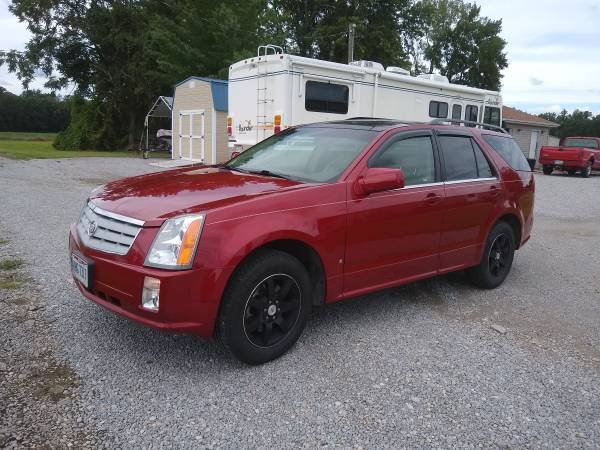

Cadilac SRX wont go into park
2008 Cadfillac SRX
Car wont go completely into park
Shifter assembly. Micro switch inside the shifter isn’t reading park. Requires replacement of the entire assembly unless you’re willing to take it apart and wire the switch closed.
Sounds like you need to adjust the the nut on the shifter linkage to make that last 1/4 of an inch to get it all the way in park. From underneath the car, above the transmission is the slotted shifter linkage attachment for the trans. There is a 10mm nut that you can loosen and then move in that slot and then re-tighten to correct this condition.
