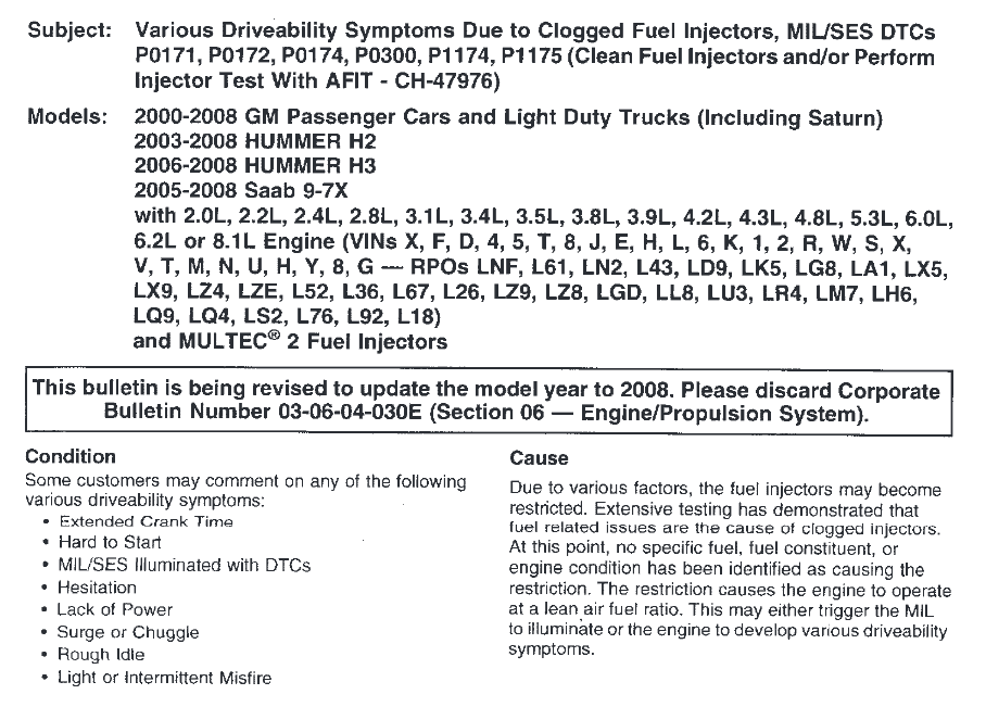

In 1986 almost all manufacturers decided to go with excessive vacuum controls on the engine. The most common cause of a lean condition is related to a vacuum leak. With this engine having so many vacuum lines I would start there first and then consider the intake gasket may also be leaking due to age. Lastly check the fuel injectors. There is a technical service bulletin out that concerns the fuel injectors becoming clogged and causing a lean condition and a lack of power.
TSB# 03-06-04-030F
