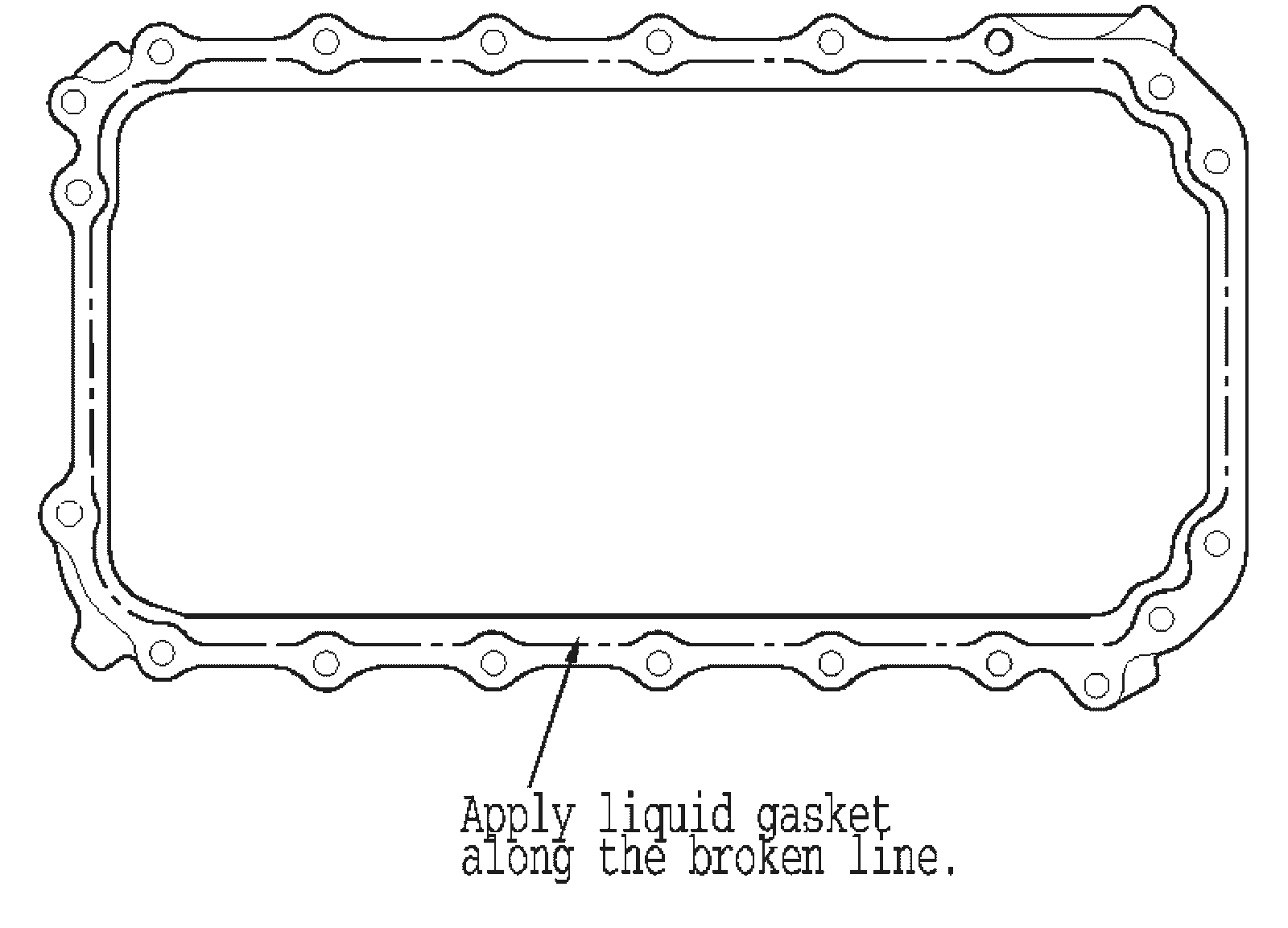

3. Apply liquid gasket, P/N 08717-0004, 08718-0001, 08718-0003, or 08718-0009, evenly to the oil pan mating surface of the block and to the inner threads of the bolt holes. Fig. 1:
2004-honda-civic-oil-pan-gasket-replacement
a. Apply a 4 mm wide bead of liquid gasket.
b. Apply a second bead where the two ends of the first bead meet.
c. Do not install the parts if 4 minutes or more have elapsed since applying liquid gasket.
d. Instead, reapply liquid gasket after removing the old residue.
