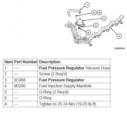

Fuel pressure should increase on moderate throttle. Wouldn’t hurt to replace fuel filter and recheck fuel pressure readings. The Auto Repair Manual shows the fuel pressure should be 35 – 45 PSI. So I’m thinking the fuel pressure regulator is at fault.

Check the vacuum hose leading connected to the fuel pressure regulator first. Replace if cracked or brittle and test. If the hose is good, replace the fuel pressure regulator and test. Still not enough pressure, replace the fuel pump.
Fuel Pressure Regulator
Removal
  1. If removing fuel pressure regulator (9C968) with fuel injection supply manifold (9D280) installed in vehicle, perform Fuel Charging System Pre-Service Procedure and Fuel Pressure Relief procedure as described.
  2. Disconnect vacuum hose at fuel pressure regulator.
  3. Remove the power steering hose bracket.
  4. Remove fuel pressure regulator from fuel injection supply manifold and discard used sealing O-rings and face seal.
Installation
  1. Install fuel pressure regulator into fuel injection supply manifold using new sealing gaskets, O-rings and face seals. Tighten fuel pressure regulator to 25-34 Nm (19-25 lb-ft).
  2. Install the power steering hose bracket.
  3. Connect vacuum hose to fuel pressure regulator.
1997-ford-taurus-fuel-pressure-regulator-diagram
