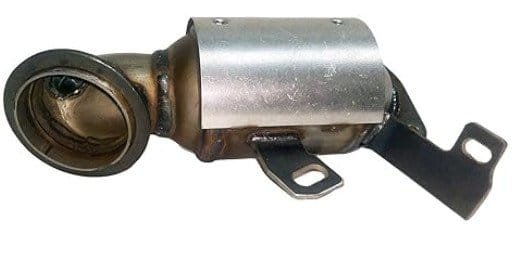

An OEM Catalytic converter would be the best way to go for most individuals that aren’t equipped with welder or welding skills. Like this Front one available form Amazon: Davico 19518 Catalytic Converter
Gaskets are included with this catalytic converter. Made in the USA but not legal for use in California.

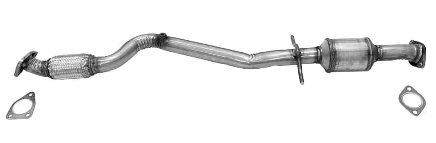

Not what you are going to need but just for example. Here is a picture of a rear catalytic converter for the 2013 Chevy Cruze:
