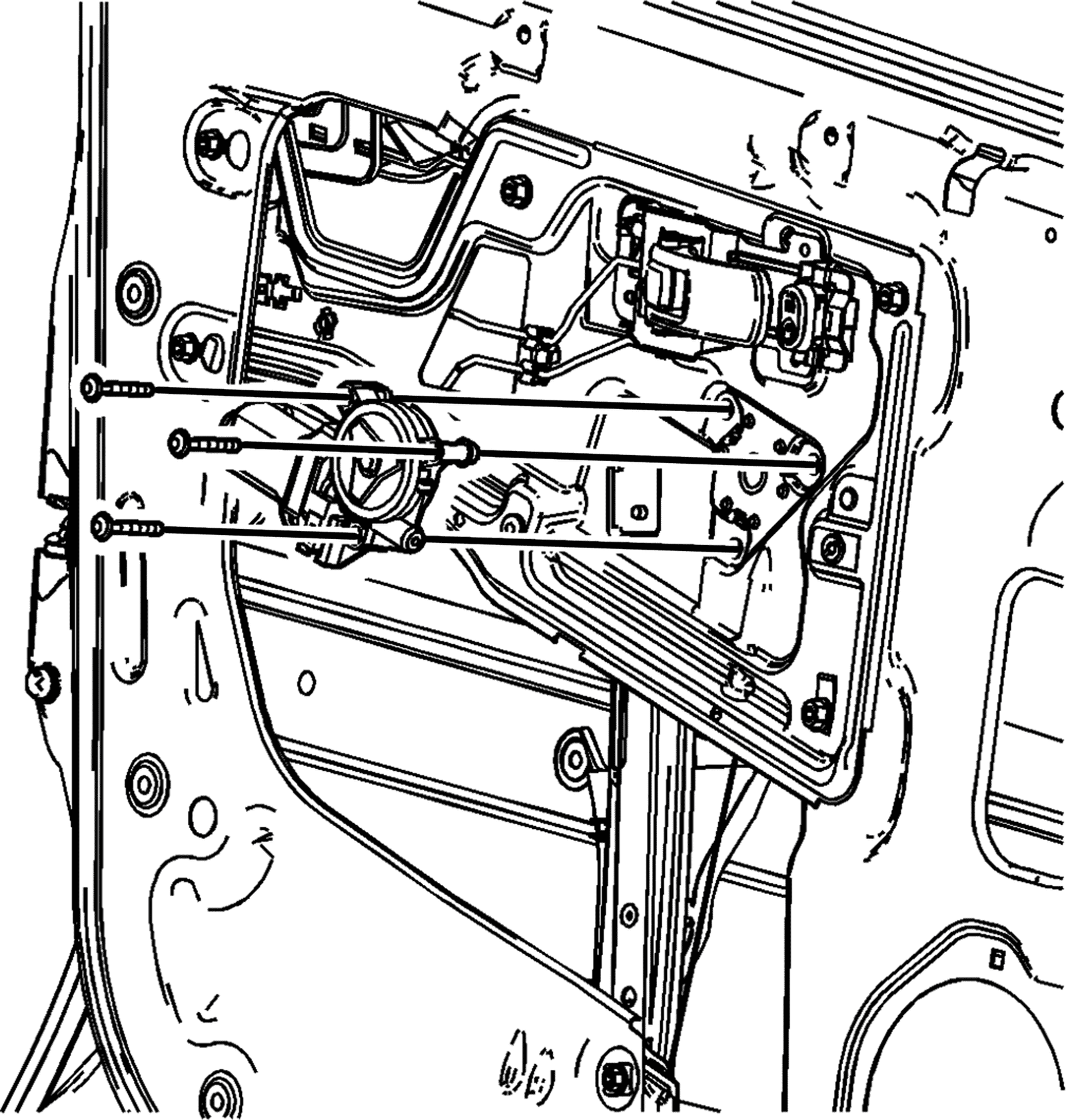

My first thought would be the window motor regulator assembly is faulty. The motor is working but the window is not. And the window regulator is a common failure part. I have taken the time to look up the part for the right front window(driver’s side).

Front Window Regulator Replacement
Front
- Remove front door outside handle.
- Next, remove front door window run channel assembly.
- Remove front door lower speaker.
- Disconnect mirror electrical connector.
- Disconnect four electrical connector rosebuds (two at mirror and two under speaker).
- Loosen two rear module bolts, Fig. 1.
- Remove four remaining module bolts, Fig. 1.
- Remove three latch bolts from door shut face.
- Disconnect door harness at door jamb.
- Remove window regulator module from door, Fig. 1.
- Reverse procedure to install, noting following:
a.Install three latch bolts to door shut face. Torque bolts to 89 inch lbs.
b.Install four module bolts. Torque bolts to 71 inch lbs.
