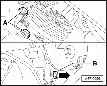

►Loosen bolts A for A/C compressor approximately two rotations and drive back threaded sleeves B in the direction of the arrow. Remove bolts.

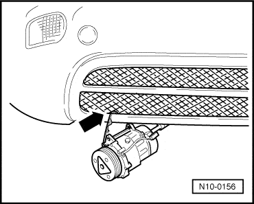

►Remove A/C compressor with connected lines out of bracket.
  • With 2.3 L engine installed, lock carrier must be brought into service position first.
  • For vehicles with boosted cooling system, right auxiliary fan must be removed and radiator must be protected from damage using cardboard.
►Mount the A/C compressor in such a way so that the refrigerant lines/hoses are not burdened.
  • Protect bumper from damage using adhesive tape.

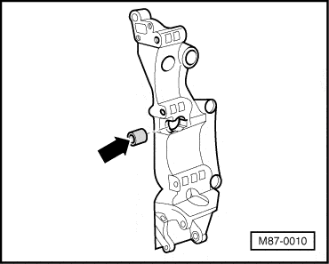

  • Make sure that version A, sleeve for A/C compressor arrow is installed for vehicles with A/C compressor bracket.
2002-vw-beetle-ac-compressor-braket-diagram
►Before installing A/C compressor, slide sleeve B completely into hole in A/C compressor.
