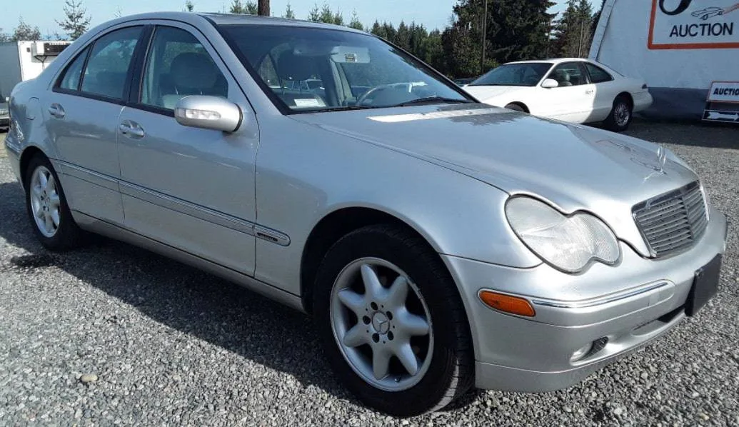

I had faced a problem with my w203 c240 2002, when start the engine, it shows in the dashboard SRS faulty and ESP faulty and the transmission not work in right decision. I turn the ignition off and then try to turn it on, the faulty will be disappear, then after 2 mins the problems appears the same in the dashboard and the same as the transmission.
the faulty shows in the dashboard like (SRS – Check coolant level – ESP – ABS).
