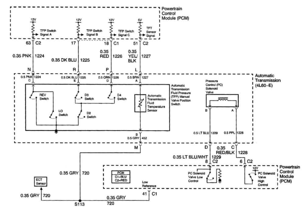

Any codes present. The transmission codes would help to pin point the issue. There could be a faulty sensor such as the VSS or an open/short in one of the shift solenoid circuits. It could be as simple as a failed shift solenoid. But if you had the codes it would tell you exactly which one/s.
