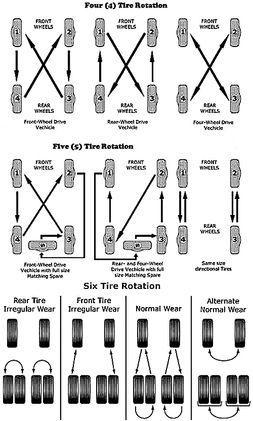

I recommend following the manufacturers recommended tire rotation procedure listed in the owners manual.
Listed in the free resources manual:
TIRE ROTATE
1.Raise and support vehicle using a suitable lift. 2.Inspect tires for wear and proper inflation pressure. 3.Remove vehicle lug nuts/studs. 4.Remove tire and wheel assemblies. 5.Rotate tires as illustrated in Fig. 1. 6.Tighten lug nuts/studs in a crisscrossed pattern. |
![](https://www.freeautomechanic.com/mechanic/forum/wp-content/uploads/2021/03/2018-land-rover-tire-rotation-diagram.gif)
