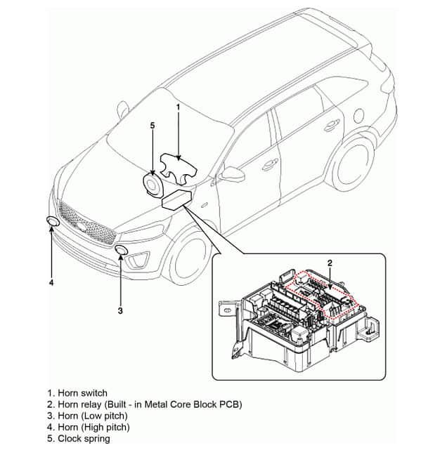

Horn Relay Location 2016 KIA SorentoMay 11, 2021May 11, 2021My horn is not working… I could not find the HORN relay to check.. I open the fuse box under the hood but I could not find it.. Please help. – Thank youHorn Relay Location2016 KIA Sorento Horn Relay Locationprevious2004 2.0T Saab Convertible ARC jumpynext2006 Chrysler 300c v8 hemi locked up
