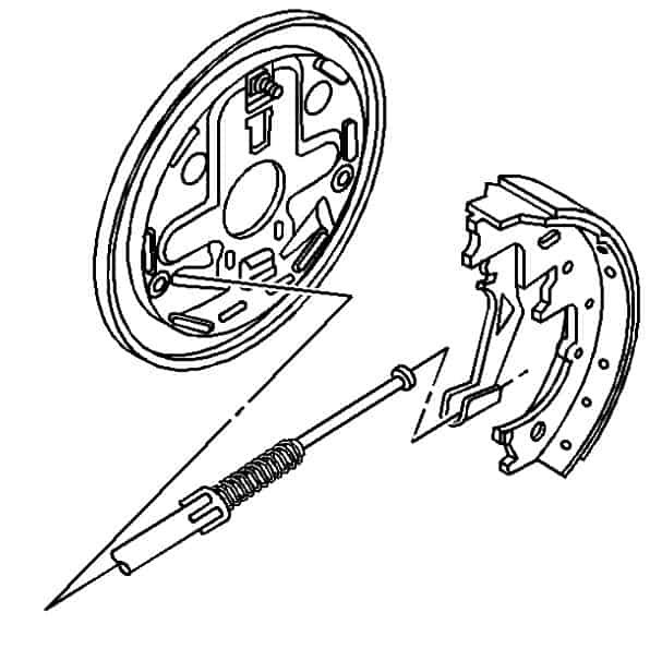

Is there a spring on the parking brake cable between cable and lever inside the brake drum? Right rear, passenger side. 1995 gmc sonoma, extended cab SLS, 4.3
Yes.
