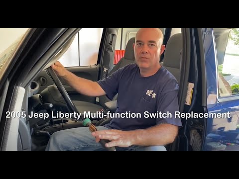

How to Replace multifunction switch Jeep Liberty Video
multifunction switch jeep liberty
Replace Multifunction switch 2002-2007 Jeep Liberty (in Minutes) #jeepliberty
Remove multifunction switch
