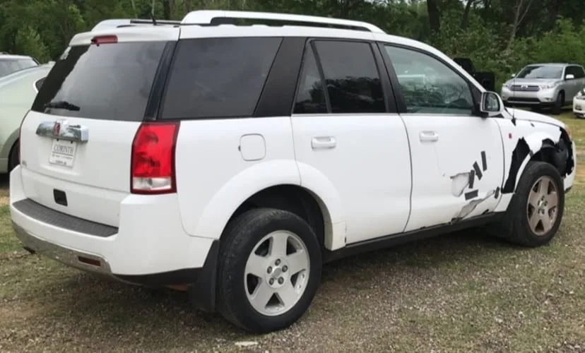

My GUESS would be that the vehicle has been in a wreck and something isn’t lined up right underneath. Of something has failed allowing the shaft to move more than it should be. Like maybe the bearings in the hub or a broken sway bar link, etc. Other than that there may be some damage on the receiving shaft that is allowing the shaft to slip back out.
