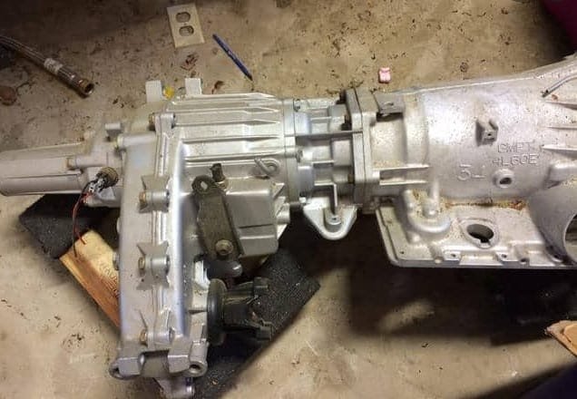

This is a 4×2 truck if I put a 4X4 transmission in it would I need to change the drive shaft?
Yes. You would need a shorter drive shaft that would accommodate the added length of the transfer case.
