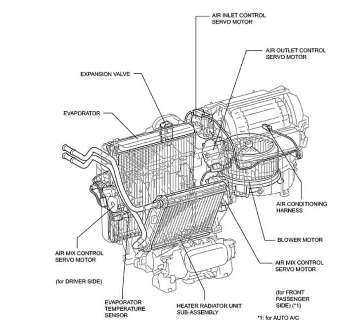

I agree with your thinking it is something electronic. This is of course assuming your coolant level isn’t low. But yes, there is an actuator or electronic air mix control servo motor that controls the temperature blend door. This is probably the cause of your problem. Having it replaced may be the fix.
