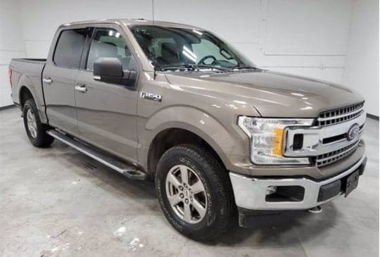

I recently made a repair and had to reset computer. I have driven 585 miles in the last 9 days, 6 of them doing exactly what the owner’s manual suggests for clearing for IM testing. Everything is ready but the EVAP, it is still flashing. Why hasn’t it cycled yet and what can I do. It is 11 days past inspection. My vehicle is a 2018 Ford F150 3.5L ecoboost 31000 miles
The outside air temperature would be the cause If I had to guess the reason it has not cleared yet. Reading the information provided below you can see the EVAP Drive Cycle needs to occur with ambient air temperature between 40 – 100 degrees. If you are in a state with temperatures below 40 then it would have a direct impact.
