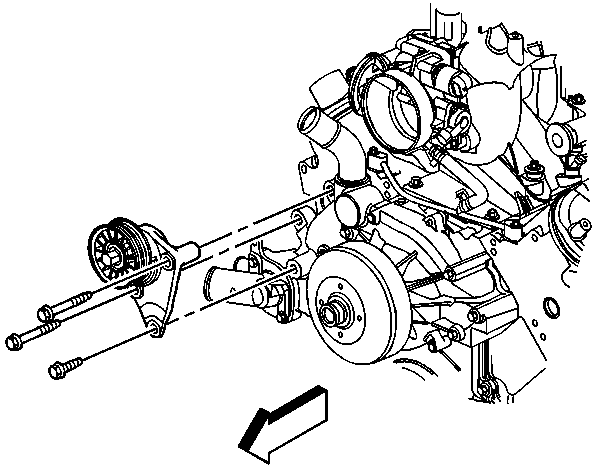

DRIVE BELT TENSIONER PULLEY, REPLACE
REMOVAL
  1. Remove accessory drive belt.
  2. Remove drive belt tensioner bolts.
  3. Then Remove drive belt tensioner, Fig. 1.
    INSTALLATION
  4. Install drive belt tensioner, Fig. 1.
  5. Install drive belt tensioner bolts.
  6. Torque bolts to 37 ft. lbs.
  7. Install accessory drive belt.
Fig 1.
