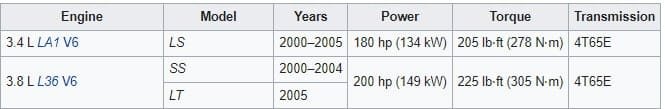

The 2002 Chevy Monte Carlo came with the 3.4L engine and the SS Version came with the 3.8L engine. There are lots of aftermarket performance parts available for the 3.8L engine.
