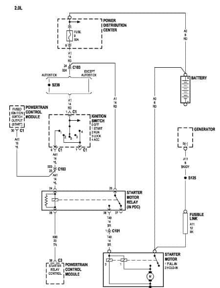

Hello, I changed timing belt, 5 sensors , new injectors but now does not start. Seems starter relay functions but doesnt have 12v at pin 30 .
Looking at the wiring diagram I think the first thing I would check would be the Fusible link.
Starting System Wiring Diagram
