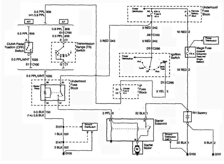

Make sure the shifter is in park. Yes, I have seen this. The next thing I would check would be the starter relay in the under hood fuse block. These would be the most common things. And of course you would want to check the couple fuses in the circuit. I will provide you with a wiring diagram of the starter circuit for reference below.
1999 Chevy Suburban Starter Wiring Diagram
