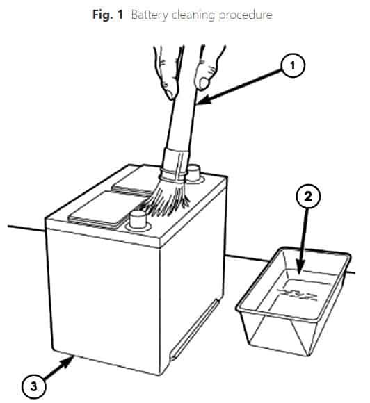

- Remove battery from vehicle, as required.
- Clean top of battery (3) with a solution of warm water and baking soda (2), Fig. 1.
- Apply soda solution (2) with a bristle brush (1) and allow to soak until acid deposits loosen, Fig. 1.
- Rinse soda solution from battery with clear water and blot battery dry with paper toweling. Dispose of toweling in a safe manner.
