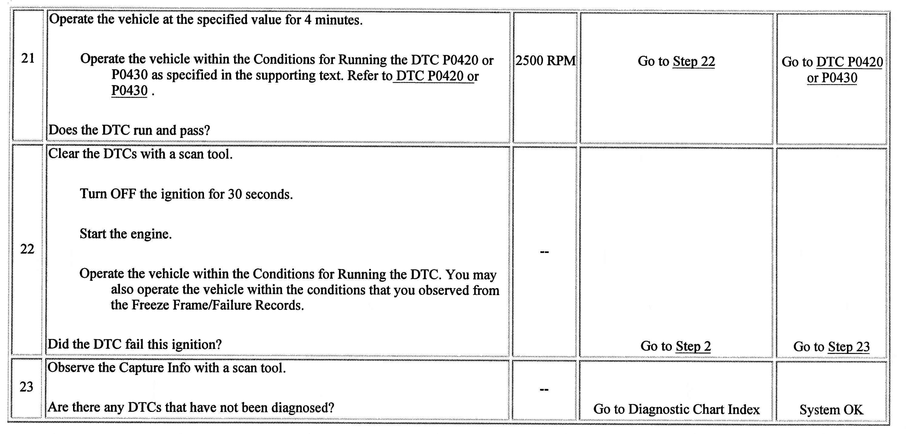

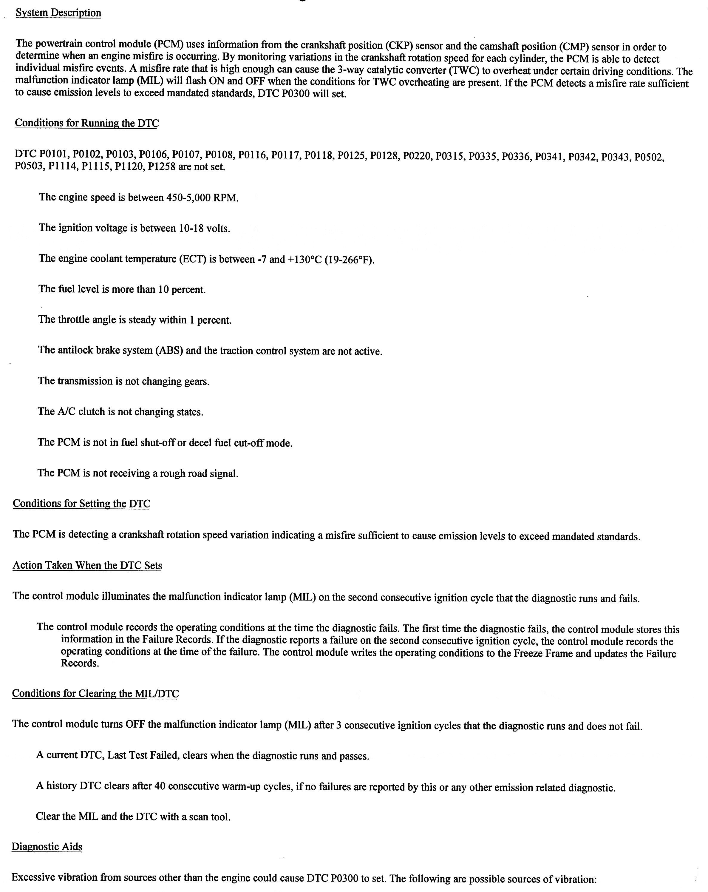

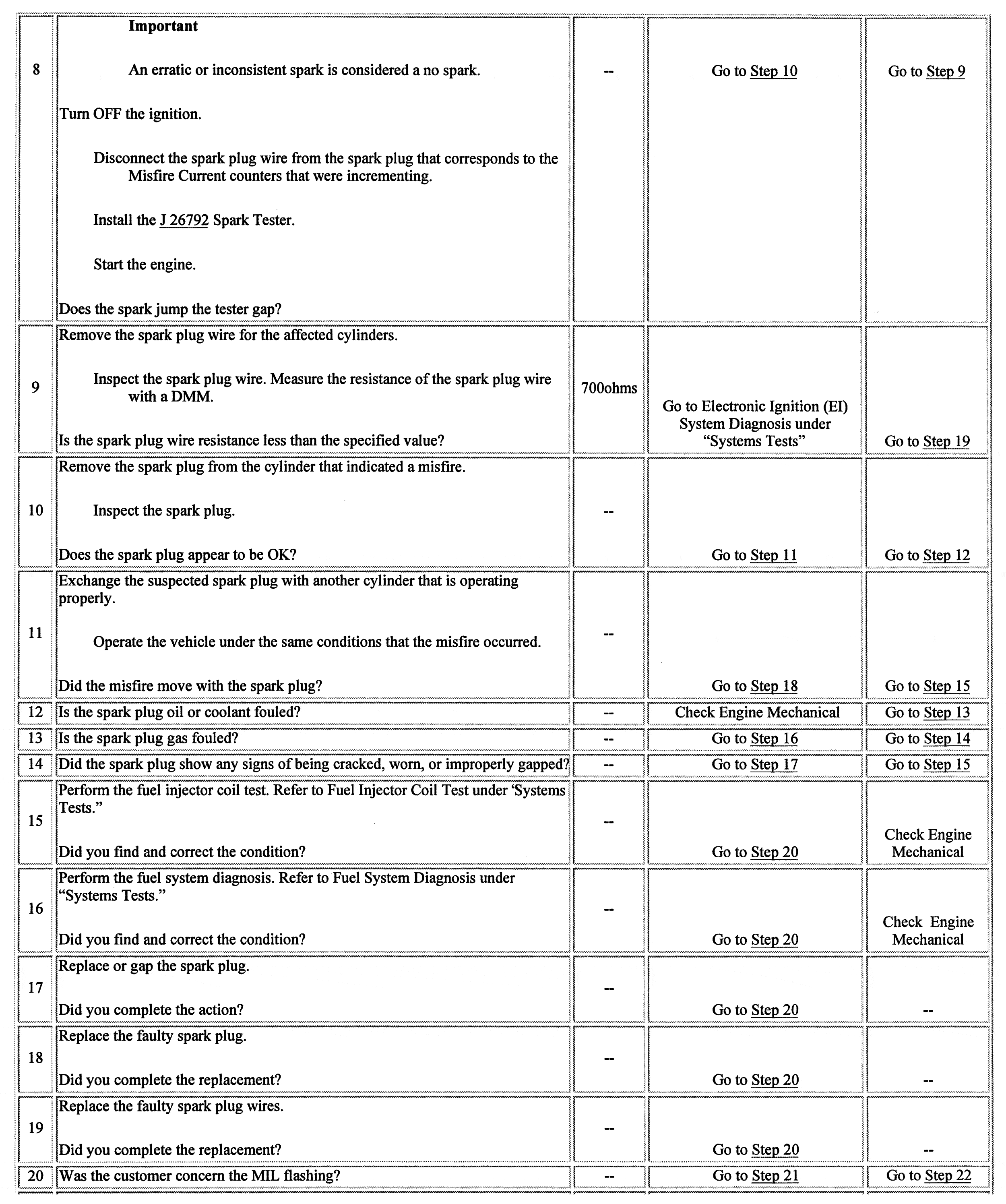

Though the cause of the problem may or may not be the intake manifold gasket I still am leaning toward a vacuum leak of some kind. Since you have a p0300 misfire code it also falls in that category. But lets get you the technical information so we don’t leave anything.
Chevy Code P0300
