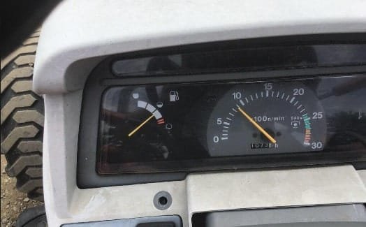

That’s right. The signal is received from the AC output on the alternator. So it is safe to assume it would be an AC signal. The wire is usually marked on the alternator in one of a variety of ways: AC, AUX, S, R, TACH or nothing at all. Generally hooking up a known GOOD tachometer will insure correct operation. But that isn’t what you wanted to know. So I did some digging and came up with the following.
Tachometer Troubleshooting
How to check for the presence of a signal on the signal terminal
If you know you have good battery positive supplied. Measure the signal between the signal and ground terminals. This should read in excess of 2 volts DC.
If power and signal are present, then it is possible that the tractor tachometer is damaged.
