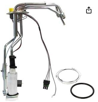

Pretty much anything less after making sure you do not have a restriction means replacing the fuel pump. Needing to replace the fuel pump is quite common on these trucks. Restrictions may be a clogged fuel filter or kink in the fuel line. But most often the fuel pump is what is needed.
Looked up the fuel pump for you that fits the 1996 Chevy Truck.

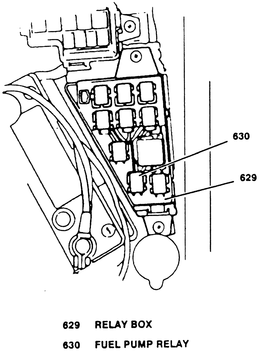

1996 chevy c1500 fuel pump relay location diagram
FUEL PUMP RELAY LOCATION
C & K SERIES
Gasoline Engine
MAIN PUMP
1994 – The fuel pump relay is located on the rear righthand side of the engine compartment, near the battery.
1995-97 – The fuel pump relay is located on the lefthand side of the engine compartment, inside the relay center.
