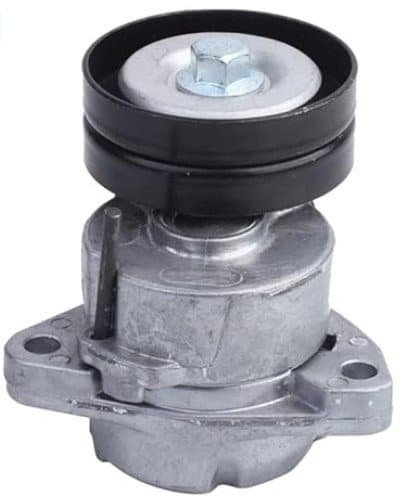

On models equipped with automatic accessory drive belt tensioners, the belt tension will automatically be set by the tensioner. Some tensioners incorporate a tension indicator band. If the belt tensioner indicator is not within the band limits, the drive belt may need to be replaced.
Purchase Isuzu Drive Belt Tensioner: https://amzn.to/49uuOjt
