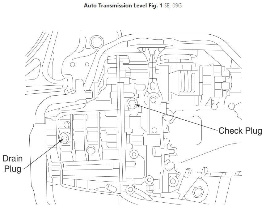

How to Check Transmission Fluid Level without Dipstick 2008 VW Beetle
Transaxle must not be in emergency running mode. Engine should be at idle in PARK. Transmission fluid temperature must be 86° to 113° F (30° to 45° C). Use of an ifrared thermometer gun works well for this. Open the screw plug on the bottom of the trans. Level is correct if a small amount of fluid flows from the hole. Add fluid up and through the plug A. Do not dislodge filler guard cap inside fill hole with filling tool.
Use a hand held Ifrared temperature gun to check transmission temp.
