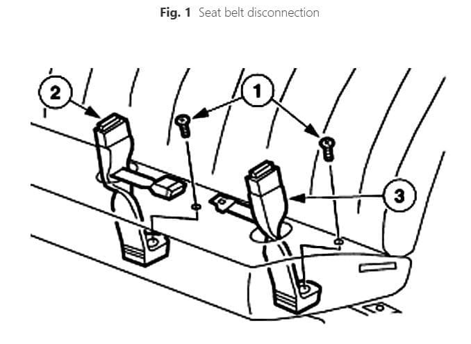

  1. Remove buckle bolts (1), Fig. 1.
  2. Feed buckle assembly up through top of seat cushion and remove front seat safety belt buckles, Fig. 1.
  3. Feed lefthand driver buckle and center passenger tongue assembly up through top of seat cushion and remove front seat safety belt buckle/tongue assembly.

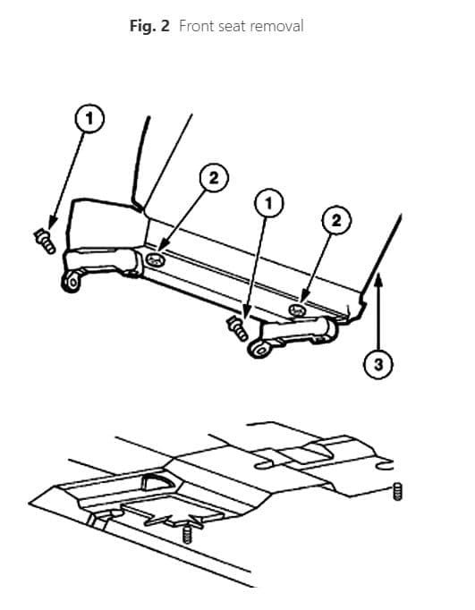

  4. Remove front seat bolts (1), Fig. 2.
  5. Remove front seat nuts (2), Fig. 2.
  6. Disconnect electrical connectors if equipped and remove front seat, Fig. 2.

seat belt diagram
1999 ford f150 seat removal diagram
