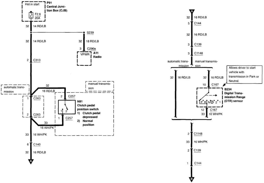

The radio also didn’t work. There was one 20 amp fuse burnt which I replaced in the under-dash fuse box. I found no other fuses burnt anywhere. I looked intently under the hood in the fuse box there, and also checked whatever I could find. I did not find any fuseable links that appeared burnt of fried, and no wires that appeared damaged anywhere.

You fried something for certain. And most likely one of those fusible links. The 20 amp fuse that was burnt may have been your radio issue according to the wiring diagram. You might see if it has spark by spraying some starting fluid in the air filter while cranking the engine over.
