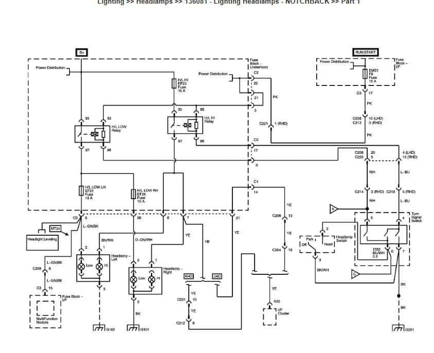

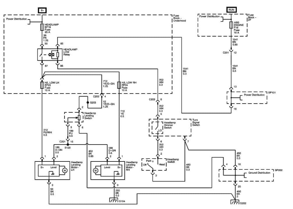

Standard: when the e-brake is down the day lights come on. Problem: when the day lights are on, the passenger head lamp is off while the driver side is on. Once the actual headlights are turned on, they switch and the passenger head lamp is on while the driver side lamp is off. Question: is there a short in the wiring somewhere or is it the head lamps? How do I fix this?
use the wiring diagram to trace the wiring harness to locate the issue.
