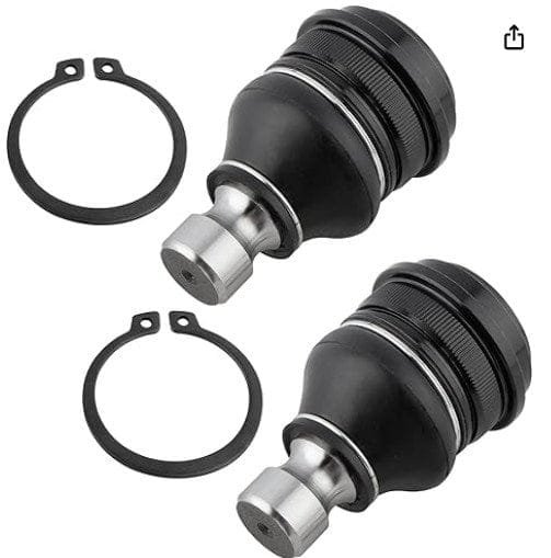

On your 2004 Sebring both the upper and lower front ball joints are serviceable. No, there is no requirement for replacing ball joints all at the same time. Though it may be beneficial to your wallet doing them both at the same time should there be plans to replace them down the road anyway. The parts pictured below are for a 2004 Chrysler Sebring Coupe.
Front Upper Ball Joint 2004 Chrysler Sebring
front upper ball joint chrysler sebring replace
Front Upper Ball Joint Replacement
