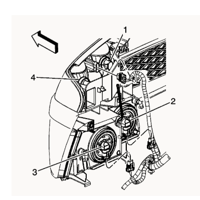

Chevy Colorado Head Light Bulb Diagram
  1. Ensure that the headlamp switch is in the OFF position.
  2. Ensure that the ignition switch is in the LOCK position.
  3. Remove the front grille.
  4. Remove the bolts that retain the headlamp.
  5. Push and rotate the high beam headlamp (2), low beam headlamp (3) 1/4 turn counterclockwise in order to remove the bulb, if needed.
  6. Disconnect the electrical connector.

  1. Connect the electrical connector to the bulb.
  2. Push in and rotate the high beam headlamp (2), low beam headlamp (3) 1/4 turn clockwise in order to install the bulb.
