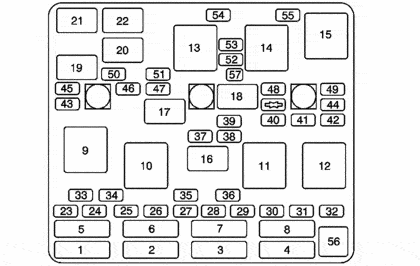

  2. My 2003 grand am just cut off. When I tried to restart it it seems like it’s out of gas. I need to know witch fuse to check, where are the filters and how to get to the fuel pump
  3. Filter – There is no service interval for fuel filter replacement. Only replace the fuel filter if the filter is restricted. Inspect the fuel tank internally and clean the fuel tank if you find a restricted fuel filter.
    Fuel Pump – Located in the fuel tank. Removal of fuel tank required.
    Fuel pump relay – #18
    Fuel Pump fuse #48
    Engine Compartment Fuse Box
    A quick test to see if the issue is fuel related would be to spray starting fluid in the air filter and see if it will start for a few seconds.
