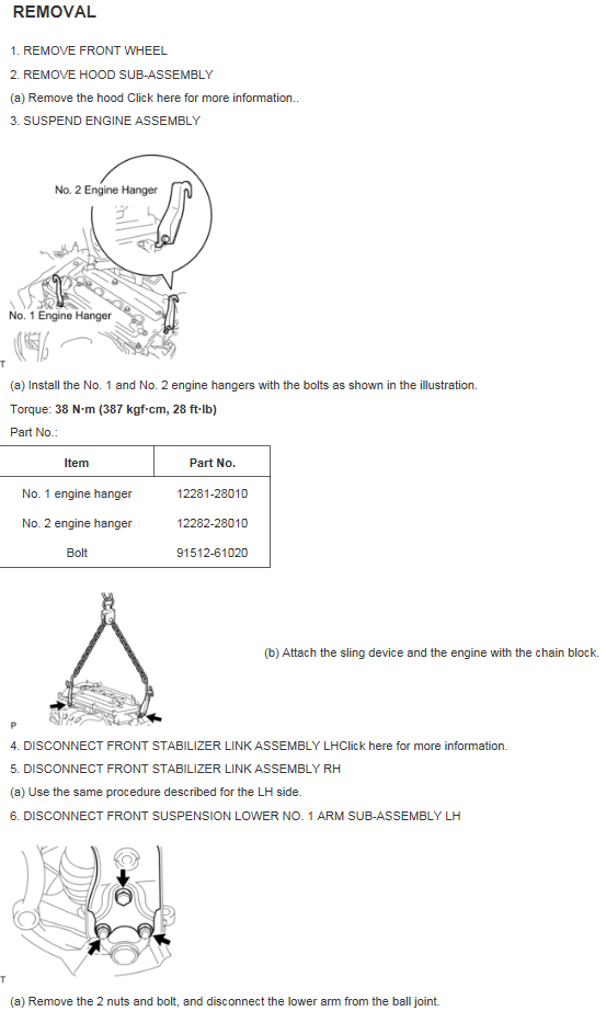

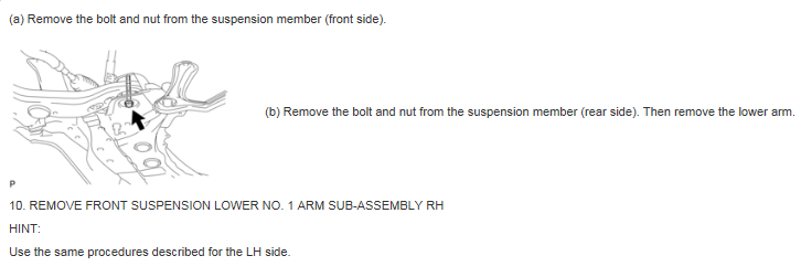

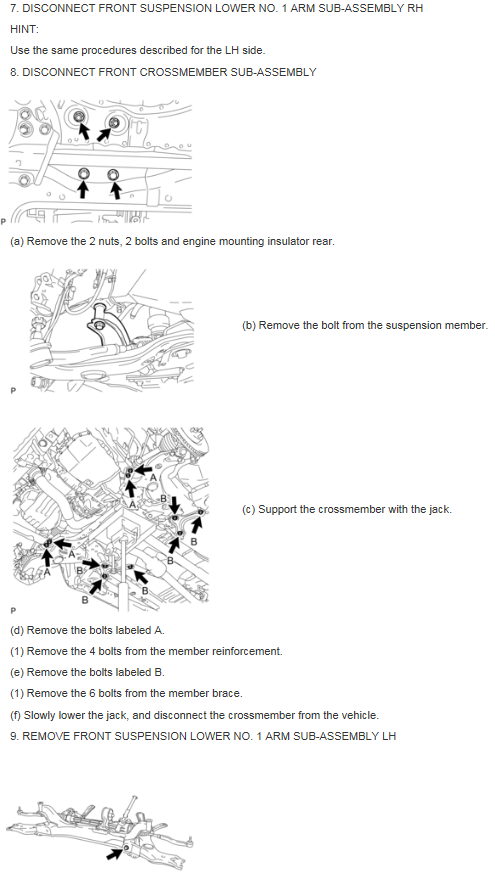

What is the easiest way to access the bolt on the lower control arm on the drivers side where the transmission is in the way. The motor mount on that side seems difficult to access as well, making the option of raising the engine not possible.
2012 Toyota Rav 4
Front Lower Suspension Arm Removal:
