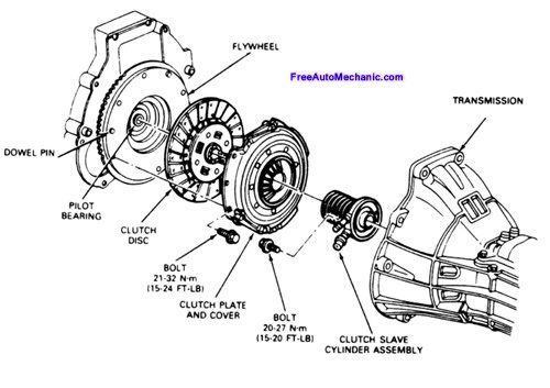

Your throw out bearing is shot or the flywheel has a crack in it…. Most likely the throw out bearing. There is no pressure on it when the clutch pedal is not pressed and allows it to make noise and when you press it in,,,,, no noise.
In your case the bearing is made into the slave cylinder. Sometimes you can get lucky and lubricate the area and reduce the noise, others require replacement.
