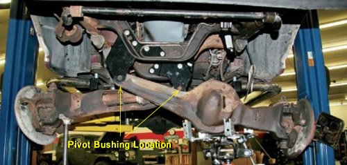

I have been told by a front end shop that I have a “right pivot bushing bracket not attached to vehicle and pivot bushings worn out”. I have looked under the truck and do not see any thing loosed or not fastened. Could you please tell me where these “pivot bushings” are located? Thank you. Jeff
1996 Ford F 250 4×4
Keywords:f250
They are located at the end of the suspension arms.
Here is a third party video that shows it up close and what is involved with replacing them.
