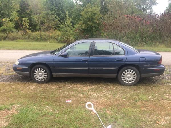

1995 Chevy Luminashifter will not come out of park
